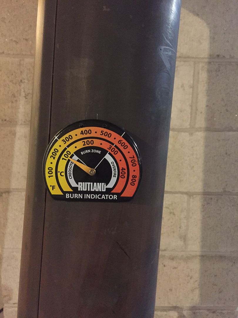

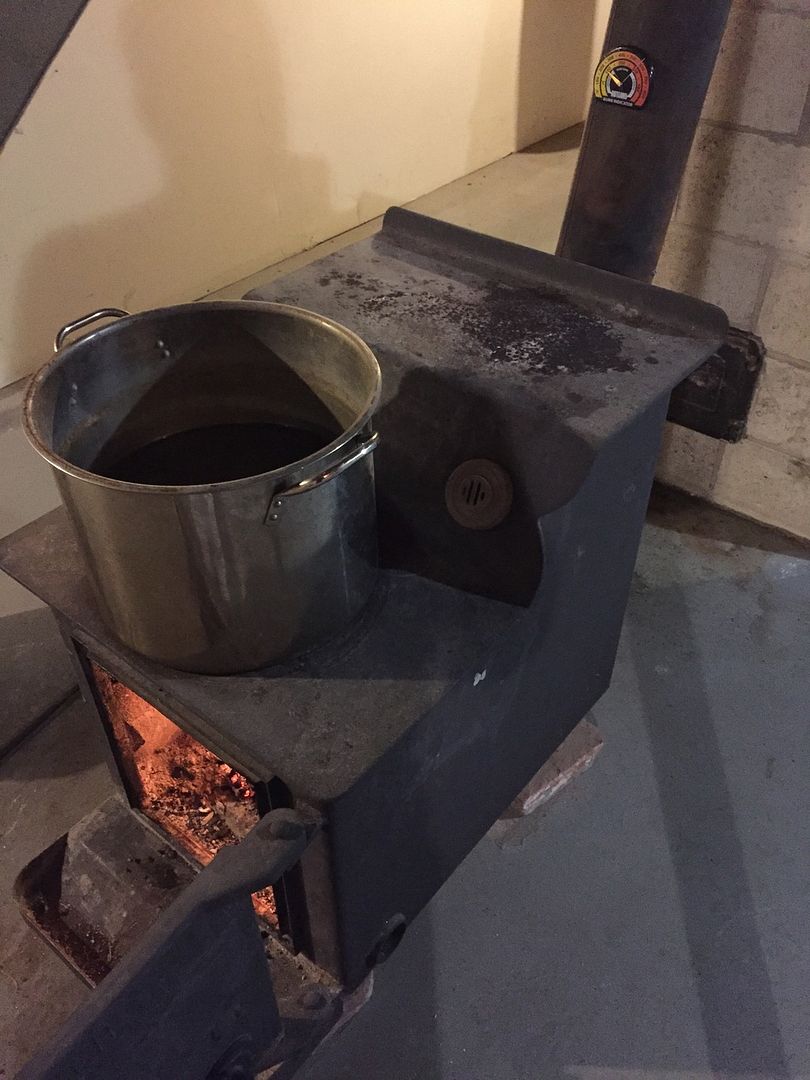

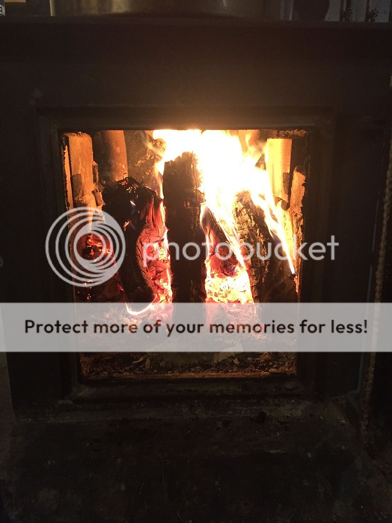

Thank you for moving the thread. I suppose I should include some photos so here goes. All three were taken at the same time. I have lots of hot coals and a good burn going, yet the thermometer located on the pipe is registering just above 200. I had a lot of creosote build up from last winter doing improper burns with bad wood so I want to do better this year, which is why I picked up the thermometer. Now I just need to know where to put it. Thanks!

For the stovepipe, that looks like a good location. During the cruise in the burn, you'd want the temp on the stove pipe in that spot to be in the zone I showed you on the condar stove pipe thermometer.
If you want to move the thermometer to the stove top, usually you'd want it in the hottest spot. Since you have a pot on the stove, experiment with it on the flat top above where the pot is, and keep things in the zone that's mentioned in Condar's stove top thermometer, when you are cruising along with a load at it's peak.

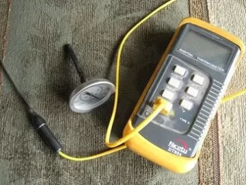

I would recommend either an electric or mechanical probe thermometer. Get the proper temp from inside the stove pipe.
[Hearth.com] Stove Thermometer Placement
Looks like single-wall pipe. Most stove pipe probe thermometers are designed for double-wall.
