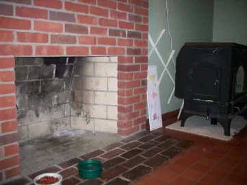

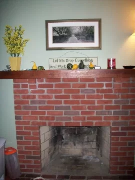

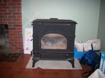

Thanks Rick... I've attached some photos. -Paul

How about taking the legs off the stove . You could get 4" legs for the DW . You could cut the legs and leave about 1 " air space under the stove . If you look under the brick you could see how hi up the smoke chamber starts . You mite have some room to remove the brick. You know the out let from the stove flips around and gos out the back.

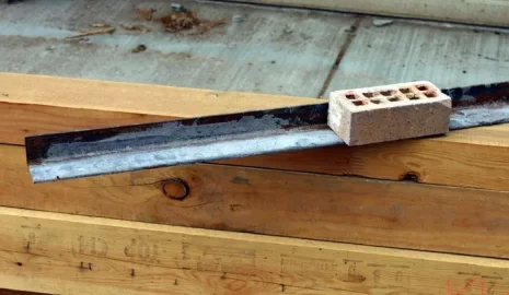

If you look closely at the way your fireplace is constructed, what you'll find is a steel "shelf" supporting the first course of brickwork at the top of the fireplace opening. This is a lintel. It's a piece of angle iron probably 3 1/2" x 2 1/2" x 3/16", or so, embedded into the mortar joints on both sides. This is a critical structural member (think "header"). Trying to increase the height of the fireplace opening would be a major undertaking, if it's even feasible at all. Forget about it.
If you're hell-bent on installing that stove in that location, then it's gonna be a hearth stove sitting in front of the existing fireplace. This will require extension of the hearth, and possibly removal or shielding of the wood mantle. How you exhaust the stove is something that needs to be determined. By far the simplest would be to rear-exit and go up the existing chimney, if it'll fit (1 90 elbow). Next best would be to top exit and go straight up through the house to daylight, not using any portion of the existing chimney (no 90 elbows). My last choice would be to top exit and go vertically a ways and then penetrate the chimney structure (2 90 elbows).

This is what I'm talkin' about. The first course of brick that defines the top of your fireplace opening is mortared to and being supported by an embedded length of stout steel angle iron. You really don't want to mess with it. Rick

Curious..what kind of stove is that?

Another option is to reverse the flue collar which is easy on a Dutchwest. It would mean a horizontal exit vs. a vertical, but it would reduce the effective height several inches, maybe even enough to avoid the alternatives mentioned on this thread.
Another nice feature of the DW w/ the bottom heat shield is the small floor clearance required. I have the 2479 (large DW non cat) and my cat sleeps under the stove w/o ever singing his fur. You can put your hand under the plate w/ ease. If you got the lower legs (or took the adjustment feet off entirely), that would also give you a little extra wiggle room.
