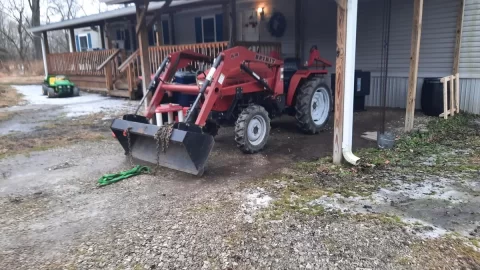

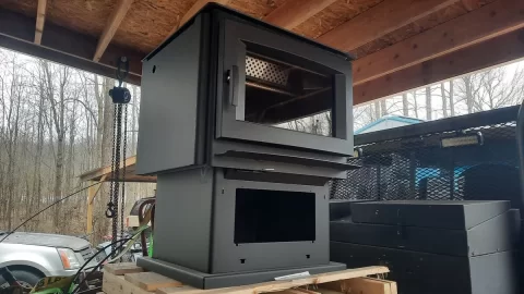

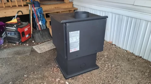

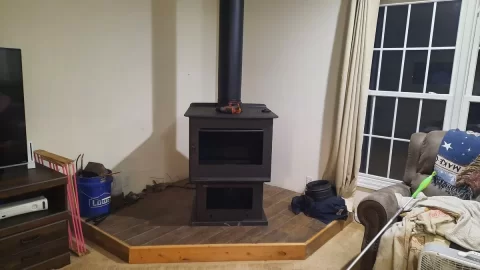

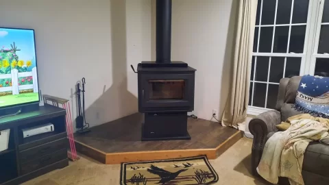

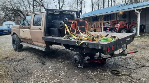

What a day! Took off early to pick up our new stove. Was fun getting it off the truck as you'll see...
[Hearth.com] Stove upgrade time!  I'm mildly excited.. [Hearth.com] Stove upgrade time!  I'm mildly excited.. [Hearth.com] Stove upgrade time!  I'm mildly excited.. [Hearth.com] Stove upgrade time!  I'm mildly excited..
Reactions: all night moe

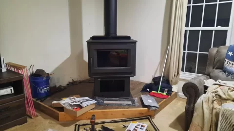

Had to pull the back tires off the truck to get enough clearance for my tractor. Even with the brick and all exterior panels/door removed.. there was no way we'd make it to the ground by hand.
Got it down... got it inside.. and got it done.
[Hearth.com] Stove upgrade time!  I'm mildly excited.. [Hearth.com] Stove upgrade time!  I'm mildly excited.. [Hearth.com] Stove upgrade time!  I'm mildly excited.. [Hearth.com] Stove upgrade time!  I'm mildly excited.. [Hearth.com] Stove upgrade time!  I'm mildly excited.. [Hearth.com] Stove upgrade time!  I'm mildly excited..

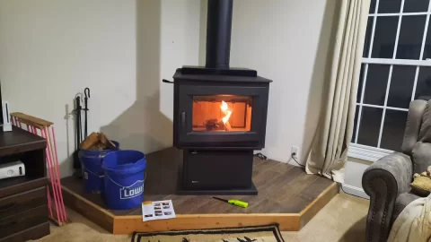

I was able to pull the stove adapter and just extend my telescopic double wall. Fit perfect.
Still need to drill a new hole and add the stack temp probe. Will probably do that here in a bit.

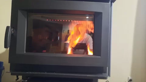

Got the first fire going and bringing temp up slow. Can't wait to see how it runs once up to temp.

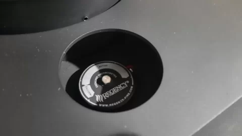

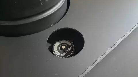

Okay... so first time operating a catalytic stove.

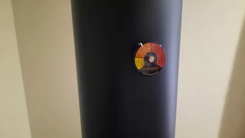

The cat lit off easily and the stove is producing great heat. My only concern is that the gauge provided with the stove for the cat temp is now nearly pegged. Air is choked down as its not super cold out and wanted to run it slow.
Stove seems to be doing what I'd expect... but was worried about the cat temp. Is it normal?
Quite a bit of metal popping and tinging sounds which doesn't surprise me too much since it's a new stove... but just want to make sure I'm good.
The logs are just a glow... no active flame... but no smoke either and cat temp is obviously up.
Looks good! No worries with your cat temp gauge...new cats are often "over active" ...it appears to be working perfectly! Enjoy!
^^that.
Enjoy!

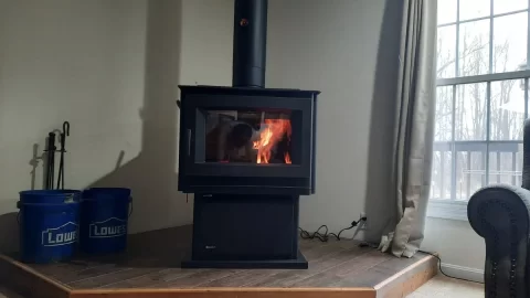

This stove is impressive. My light load yesterday for the first fire still had a hot coal bed 13 hours later and took back off this morning without a hitch.
I reloaded it with a full load this time.
It's taking some getting used to letting the thing run as hot as it does. Flue temps are staying around 500-600 (have settled down around 500 now)... The cat probe goes beyond the active range on first start but settles back down to the top of the active range after a bit and stays there.
Overall, happy with the investment and upgrade.

Sounds good to me! Flames look awesome!
Glad you've got a happy investment! And, yes, those are some nice looking flames!

That's a good-looking stove and installation. Enjoy the heat.
Have you tried closing down the air a bit sooner to lower the initial cat temp spike?
