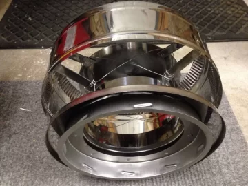

I bought my supervent from lowes so maybe my storm collar is differant cause it fit great! As far as the cap i dont have a problem with it, i just added some ss lashing wire to make sure no birdies get in there like ive heard.

Good idea cableman! The wire mod is now on my list, as I've got 2 supervent chimney caps like that.
