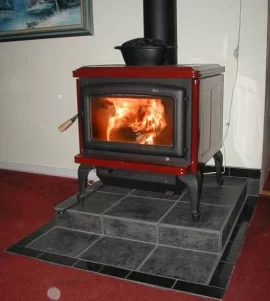

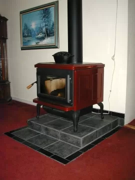

Great looking stove . Easy to clean . stays clean looking all winter . The red get just a little darker when hot and lighter when cool . Love this stove . Its worth every cent for the Porcelain add on .
