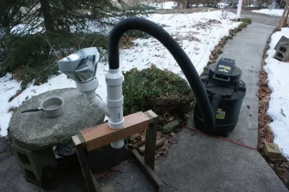

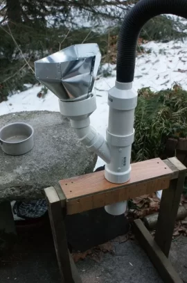

I have no idea if more bags are in the same condition so decided to make one of those dust separators. Went you know where (HD and L) to pick up the necessary parts, came home and made it up. By the time I was finished I was tired and sore so left the first test for the next day. I made some minor mistakes which will be rectified tomorrow (wrong size wire mesh and dowels too close together).
So today (Monday) I sifted one whole bag using a colander with very little dust, or fines for that matter, to show for it.
