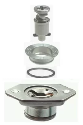

For a permanent fix and to make it easy to remove you should turn to aviation. Maybe over the top for you guys yes?
  • [Hearth.com] Stripped screw holes.
I like it. stainless yes?
