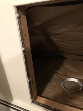

I just finished insulating and sealing my 3 attic access doors. I used a 1/4” stick on bulb seal. The other 2 doors worked fine. But this one I think is a little warped, and I can’t get it to stay latched without leaking air at the top corner. Played with the adjustment for a half hour, also tried loosening the hinges to reduce springback. The foam board is not binding anywhere. I can push on the door just a little and it seals up. The picture is an illusion, the catches are equally spaced all the way
Do they make these roller catches in a stronger version? Or something else similar? I would prefer to keep the latches internal.

it'd be nowhere near as clean of a presentation, but a latch pushing on a cam would hold the door tight.
