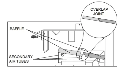

Yes, examine those hole with a bright flashlight to see if there is a screw at the bottom. The manual's illustration shows 2, one on each side.

I would try to figure out how it was assembled at the factory. Hopefully, they have made this serviceable. The air is fed to the air wash which has a deflector. Is the deflector removable or welded in?

The drawings are a HUGE help! They give me a great idea what I'm dealing with internal structure-speaking. I did entertain the idea of blasting silicone spray in there, but I'm saving that as a last resort since I figure it'll stink to high heaven the first time the stove gets hot this coming season.
