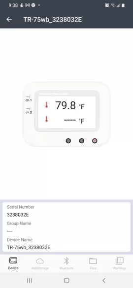

I'd just like to pass on some more info on a fun gadget that I just discovered thanks to someone on this site suggested.
I have a catalytic insert and found that the temp reader was very unsightly, and the batteries were draining unnaturally fast.
I ordered a device labeled TR-75WB from thermoworks. It can be plugged in or used with batteries.
It can transmit via Bluetooth to an app, as well as upload data automatically to a free cloud storage via wifi. ( reading and update intervals change the battery life)

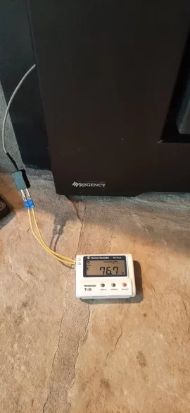

Here it is with some modified clips to fit over the k type prongs. I will remove the faceplate and hide it behind soon.

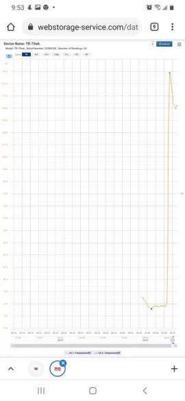

Here's a view from the app of real time readings.
Here's a graph that was produced by the online website. I just burnt a piece of newspaper to test the reader. Game changer on checking temp while away. Or easily viewing burn time efficiencies.
I'm told that thermoworks will discontinue this product so I wanted to let you guys know right away.

It's nice and compact. Better looking than the Auber box too.

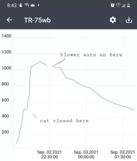

I got eager to light a fire last night since it went down to 12c. Didn't load it up too much but by the graph that it created, you can clearly see where I closed the catalyst bypass,
In the beginging I set it to recording readings every minute and later changed it to 15 minutes which in doing so erases a bit of data stored in the box waiting to be uploaded which is why there is a blank space.

Probe. See pic in first post.
