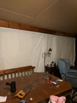

Quite awhile ago I'd mentioned that I was going to whip up "window quilts" to see if they'd make a difference in the temperature of our porch.
It's currently -4° outside with the wind chill and we're comfy sitting here at roughly 68°-70°.
I think I like how they turned out

Did you get tired before you were able to saw all the way through the table? ;)
Reactions: SpaceBus
LOL
Hubby sawed through the pvc pipe I used to hold up the quilts. That poor old table has served as 'eating area' 'sewing area' 'workbench'...just about everything!

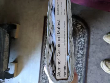

Great idea! Do you know what the material is called? Or may I ask where you purchased it from?
It's the stuff folks use to make potholders...it's waffle-ly on one side and reflective on the other.
These are just prototypes. Now that I like how they work I'll have to come up with ways to improve them.
i'm curious to know more about the materials you use to make these - i think my house could really benefit from some. i keep the blinds down in some of the rooms for similar reasons, but making curtains especially for retaining the heat and blocking drafts would be something i'd invest time in!

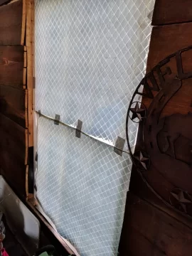

It's "fess-up" time....when negative wind chills are expected, one must hurry to get things buttoned up. Lol
This is the window I didn't have time to do correctly.
[Hearth.com] Successful test
It's the windward side of the porch so I wanted it covered.
I got the quilty stuff at JoAnn fabric. I had to order online since our local store doesn't carry it.
Be sure to sign up for coupons before you have to pay full price...it wasn't all that expensive when I got to use coupons.

Thank you so much for the info! I did a quick search: (broken link removed to https://www.joann.com/aluminor-thermal-fabric-10-yard-bolt/zprd_14898621a.html)
I own a small dog accessories company, so I already shop quite a bit at Joann's, and can whip these babies up in no time :)
