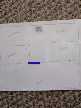

I've been pondering this for too long.... here's the layout of the main floor of our home.
To get the living room and dining room warmer, where would y'all put the fans?
(The door and both windows are always open when the burner is burning. There's good airflow...just not 'great' and those 2 rooms are quite cool.)

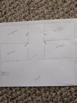

This is a tough layout to heat well with the stove. The stove is an area heater and narrow openings (doorways) to rooms don't help with heat circulation. In the least you could try to put a table or box fan at the far end of the hallway, placed on the floor, pointing toward the woodstove room. Run it on low speed. It will blow the cooler air down low, toward the woodstove. The denser cool air will be replaced with lighter warm air from the stove room. Running this way you should notice at least a 5F increase in the hallway temp after about 30 minutes running.
What room(s) do you want to spend most of your winter time in?
The TV is in the livingroom so we do spend a good deal of time in there...but the fire shining through the woodburner window is a strong draw so it's about
50% porch and 50% livingroom.
There's a top floor too but hot air rises so it's not all that bad up there. It's a big house and we got the mid-size Heritage...I think that has a lot to do with
it too....
Maybe change the config and make the bedroom next to the porch the living room?

You're probably losing nearly all your radiant heat having the stove on a porch.
Knock down a couple walls and move the stove, and your difficult layout will be pretty easy to heat and use less wood.

Are the windows double hung? If so I’d just open the top portion. I would put a small 8” or less fan on the floor pointing out the door and down the hallway of each back bedroom or one larger just at the end of the hall pointing to the porch door. Keep the cold air moving toward the stove and the hot air away. I might even try putting window fans in the top of the windows if they are double hung to force the hot air into those rooms and force the circulation pattern. Just my two cents. One small fan at the end of a 24’ hallway helped me a lot.

This looks like it'll be our best bet. We do have newer windows that will open on top...that alone made an enormous difference in
heat distribution! So I'll try a box fan at the end of the hall this winter and see if there's additional improvement. I also have
one of those 'top corner of the doorway' fans that I can use--I'll have to experiment to see which doorway it'll work
best in.
