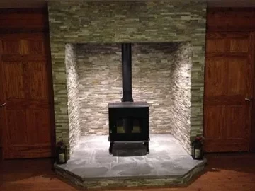

I have a gas insert that I'm yanking this spring to install a wood stove. It will be an alcove installation like the one in this photo...I reckon a similar look could be achieved in your case?
[Hearth.com] Suggestions for insert in large room
I am thinking I will have to go that route. The fireplace chimney is on an internal wall with a concrete safe room behind it so no access there!
