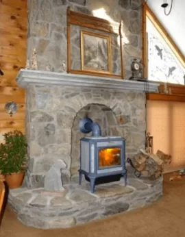

Pish posh. Maybe she just needs some visual aids.
[Hearth.com] Suggestions for insert in large room [Hearth.com] Suggestions for insert in large room
