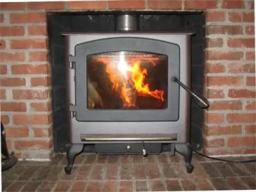

My avatar is my woodstove - a Pacific energy Super 27 made in 2004. I just replaced most of the firebrick and insulation (yep - has insulation INSIDE).
The baffle at the top is not only the air intake chamber, it is insulated and removable quite easily (within seconds).
The stove burns so efficiently (I use 3 different stove thermometers to keep it at optimal operating temperature) that I only get about a cupful of residue/creosote left on top of the baffle after cleaning out the flame arrestor/rain-cap outside.
Seeing as my chimney is almost perfectly vertical, creosote buildup is naturally minimal - any elbows increase the likelihood of creosote buildup immensely.
I had a friend who put a regular stove in the fireplace opening - he loved it. Although it took a wee bit longer for the room to warm up, the surrounding bricks retained the heat for much longer than an exposed stove would.
The Super 27 comes with an optional blower that fits on the rear bottom, blows the heat up the back and across the top of the stove outwards. I use a pair of Eco-fans to help it out . . .
The Super 27s ain't cheap tho, but I've seen used ones on-line for around 1K.
You can find the specs and measurements here ---->>> (broken link removed)
