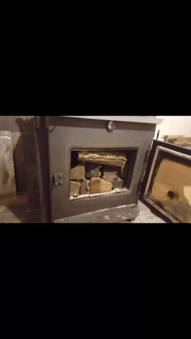

You can load north and south just fine. I do it all the time.
That's great news, you wouldn't know it by the marketing. Every single picture shows wood sideways and the andirons there to hold logs from rolling out. How much depth is there from the back of andirons to the back of the firebox? Woodstock doesn't even list firebox dimensions.
I certainly hope you're not cutting little 8" long splits of wood and then boasting about this stove being a north/south loader!
I'll have to check when I get home. It's in the neighborhood of 18" because i don't have any problem doing it. You can take the andirons out in about 5 seconds and leave them out if you don't need or want them.
Reactions: Highbeam
