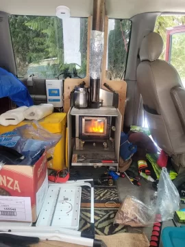

I have presented what I think is a great idea for a wood stove design to Cubic Mini but they won't likely pursue it. So I will bounce it off you.

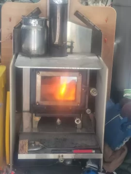

We heat and cook on a cookstove. But not in summer because it would be too hot in our house. My idea is to take a Cub or Grizzly, add a custom aluminum cooktop, and insulate all outside surfaces with the same rigid insulation used inside, including the flue pipe. That way only the cooktop gets hot. Voila! Wood fired cooking inside during the summer! I've never seen a stove like that. I think it would work. And work well.
I have already built an aluminum cooktop for the Cub installed in my 4x4 camper van. The original design has a faux fiddle that prevents cooking. I have offered to build and test a prototype but was turned down by Cubic Mini. Anyone know of a manufacturer that does consider new and interesting cookstove design?

There are quite a few heavily insulated European Cook stoves.
Any modifications done would need to go through the ul testing process and it's a large investment for a very small market.
BTW the clearances to combustibles on your stove are really really scary

I have never seen an insulated stove. Inside to keep combustion heat up, yes. Outside to reduce heating of house, no. I'd like to see reference to one to see.
My Italian wood cookstove is not UL or CSA listed. It is gorgeous and works very well.
My van stove install is surrounded by cement board. It is not combustible and doesn't get hot. No worries.
I have been doing this a very long time and that isntall is extremely scary.

But you have not used this stove in this install. Just conjecture. If the cement board got hot, I would change it. It works great the way it is. Even the freezer beside the stove is not getting hot from it.

It's not getting hot under normal conditions but if you ever had an overfire things would be quite different. Clearances are for safety under abnormal conditions which can and do occasionally happen.

The stove in my van is the Cubic Mini Cub. About as small as a woodstove gets. 9-inch cube. 6-inch long wood. The custom cooktop I added makes it look larger than it is. I used their vertical mount with the bottom tray (open to see) that will catch any ash that drops.
Cubic Mini specifies 30-inches clearance above -- I measure 29 1/2-inches. They specify 3-inches from non-conbustable surfaces. I measure 2 3/4-inches. The rear and bottom have two layers of stainless steel protection with air space between.
The real test is checking the cement board guards when the stove is hottest: I can easily keep a hand on it. Just warm.

The cubic mini cub requires 20" clearance to combustibles which can be lowered to 3" with proper mounting and shielding according to the website. I don't believe that cement board is considered proper shielding. It's your stove and camper, u can do as you wish, I'm just pointing out that it is not within specs.
I just talked with a certified woodstove installer and he said the cement board is what they use for shielding. My install is very close to specs. Just 1/4" out. And I have tested it with loads of red cedar to worst case with no problem.
The problem with those clearances is that I don't believe these stoves are listed. So legally they need the 36" clearance that can be reduced to 12. Since it's not listed we don't know how they conducted the testing or if they did at all.
