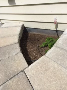

Pump the water out collected by the hp rather than using a bucket. I use an a/c condensate pump, which goes via a little clear filter (to stop the bugs crawling in) to a couple of micro sprinklers in a garden bed. Hope to grow tomato's in there this year..
It is quite funny to watch it when the water gets pumped out..
