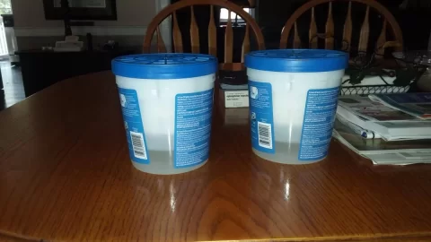

I use Pam cooking spray[non-flavored of course.] to coat inside walls..
also use 2 canisters of damprid to avoid rust...
btw: to those who claim moisture doesn't get into your stove..
those containers we're in the stove for approx 5-6 months..
Outside air was sealed off. also exhaust at top was sealed off and yet...............>>>>>>>> 2/half inches or more of water absorbed...
