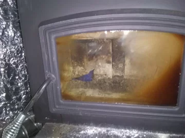

I got up this morning and heard a weird noise. Upon investigation, this is what I found. This is why I want to cap the chimney top. I took the burn tubes and the baffle out yesterday. I removed most of the ash. Later this week when the weather is nice I was going to brush the chimney. I guess I will have to try the towel method to remove him. I doubt he will fly up the chimney to escape. Wish me luck.
