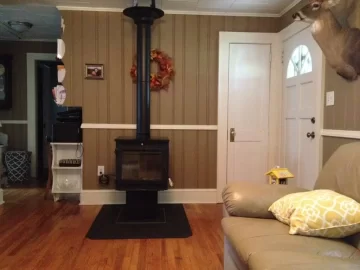

In an 1100 sq ft home with a semi open floor plan for the living room, dining/kitchen will the 2000 run me out. With the blower? Without the blower? The bedrooms are down a hall. Thinking mostly as a back up and movie night on the couch. Although a fan would get it down the short hall way to the bedrooms in short order.
I am attracted to its price, and clearances for a small home with only spark/ember protection.
Stove will be in living room.
Bathroom door in line of sight of the stove 10'
Dining/kitchen directly to the side through a 5' wide arch.
Bedrooms down hall 3' to the side of the stove then back towards the rear of the house.
Any thoughts? Also this likely isn't our forever home.

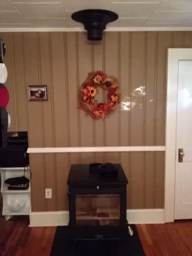

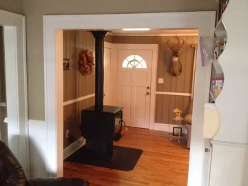

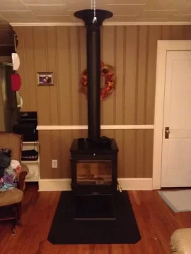

I have the super vent flat ceiling kit and the stove now. The adjustable double stove pipe is in the mail. That should make a smooth one piece connection.
The manual calls for a type 1 or equivalent spark and ember only, and specifically says, " No R-value required.".
I cut , filed, and sanded the edges on an 1/8" sheet of steel and high temp painted it. To pad/insulate/allow for shifting the stove around, I put the steel on a piece of black felt cut to recess under the steel a touch. It slides easily without marring the floor with most of my weight required to move it.
We are still trying to decide on centering it on the wall, room, or what feels to be the center of the room with the couch layout. Either way it's within a foot either side of where it will set. Corners and all edges are rounded and smooth to prevent a toenail from being harvested.
Clearances are listed at 7.5" off the back. We have it at about 9.5". Double wall will be at 14" which may allow for a thin mantle later on down the road.
Pictured is single wall I originally purchased with the ceiling trim just to get an idea for positioning.
Any questions, concerns, or recommendations are welcome.

That install is looking really good. Very simple and clean. The wall paneling behind the stove is a good fit.

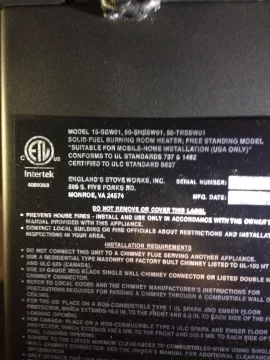

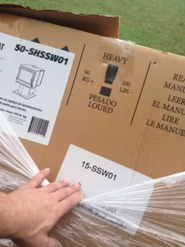

Thanks. I wasn't sure. Lowes web sight had it listed as one thing. The manual has three models on it. The stove has three models on the tag and the box had two different models on two different stickers.
All models seem to be ember only so I think I'm good.
Kinda makes you wonder. I called tech yesterday and they didn't know they made one that was spark and ember only. (Apparently they make three). I was also told that a double wall stove pipe adapter was required. I called super vent (Selkirk) and was asked a few questions and assured no adapter was needed. 1/8" collar not required... 1/4" collar would need an adapter.
I guess I would have felt better to stay ignorant and hired someone to install and me not know any better.

The 3 models are all the same stove made by Englander. They are branded differently depending on who is selling them. (Englander, Summer's Heat and TimberRidge) 15-SSW01 is Englander branding. This stove is nicknamed the Madison.
The 3 models are all the same stove made by Englander. They are branded differently depending on who is selling them. (Englander, Summer's Heat and TimberRidge) 15-SSWW01 is Englander branding.
Thanks. Good explanation.
Thanks. I wanted to stay unobtrusive. You really can't tell when you step on the floor protection it's so thin. The walls are the original tongue and groove pine from when this was built in the early 50's.
If we ever move I wanted to be able to patch a couple holes and take all with me without anyone being none the wiser that there was ever a stove there.

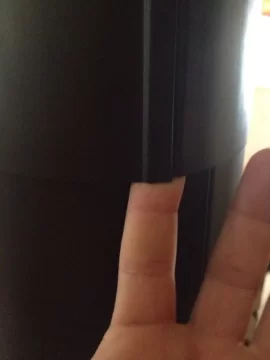

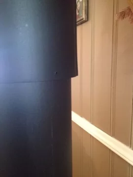

Is this gap an issue? I think the inner pieces of the double wall telescopic pipe meet better. It this just cosmetic?
