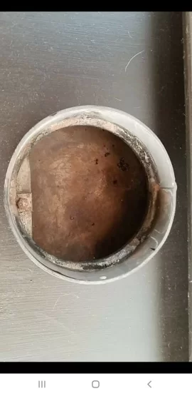

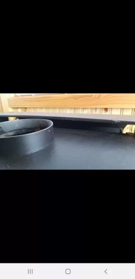

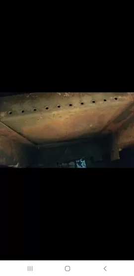

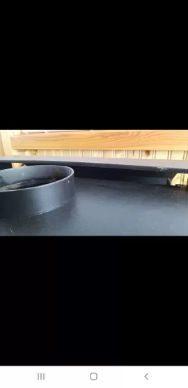

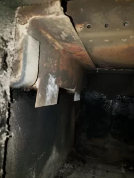

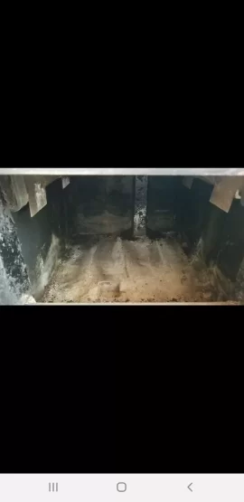

Attached are more pictures. I'm a little hesitant now. Firebrick was removed for moving purposes and broke in storage.. It was bought new several years ago but never used. Minor rust on top and painted to touch it up a bit is what the seller is saying. Rustoleum high heat paint was used, good up to 1200 degrees.
Firebrick id have to track down and buy. I don't know how hard that is to install.

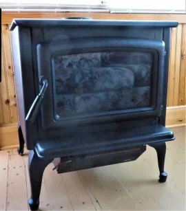

Forgot to post this one.

Re-paint was due to a pot of water slopping away on top I'd wager. Stove looks decent in the pics. Baffle doesn't appear to be warped significantly. If that's the case it sounds like a good way to cover your needs. Who knows, it may become a permanent fixture! Compared to 3800 it would free up some folding green for other needs. Worth a look.
That looks good. Grab it while you can. Given the present market, it could be a snooze ya lose situation. Firebrick is easy to put in. Do any of the original bricks come with it, even if some are broken?

The Super takes standard-sized pumice firebrick. A set is costly if bought from a dealer, but there are more affordable packs available online.
Another thing to check is that the insulating kaowool baffle side seals are still on each side of the baffle. You may be able to see them without removing the baffle.
See if they will sell the stove for $1000 due to the missing firebrick, but at $1200 this is not a bad deal.

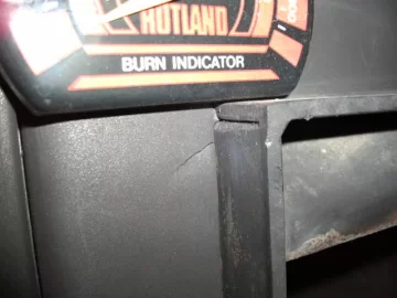

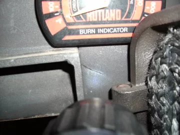

Is this the generation of PE stoves that got cracks leading away from the door corners? Something to check.
Not sure, 15 yrs may be before. I thought that was 2008-2009. I looked and didn't see any sign of cracking in the front corners, but it didn't happen to all stoves. Door gasket is falling off in that picture.
2006ish is the cracking issue era. It looks that stove was smouldered more than anything else, considering the side bricks appear to be covered in soot & creosote. You better grab that puppy while you can.
Oh, nevermind the creo comment, I didn't notice the bricks missing. Also, open the doiof and on the face of the stove just behind the top corners of the door, make sure there are no surface cracks. Also inside the stove in same areas.

This wood stove was purchased in 2008. Think im in the clear? The old age makes me a little nervous but seems like a bargain. Thanks all for the input.
Which one, the Super or the older Summit?
I thought that this came up later models. Some were reported after our stove was made (2007) IIRC.
Edit: I just searched back and found a 2010 Summit with the issue.
The Super 27 that I'm thinking of buying. 2-1-2008 purchased
OK, bought in 2008 but only used 2 seasons? It should be ok. The cracks were reported in some of the Summits of that vintage but I can't recall any for the Super.

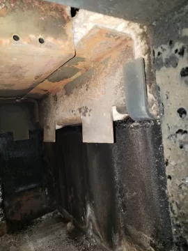

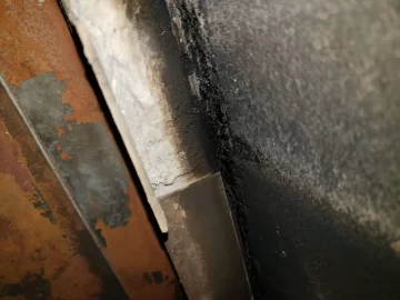

Good deal. Can you see the front end of the side sealing blankets showing along the side edges of the baffle?

Attached are a few pictures of the white insulation type fabric. Does this look okay?
