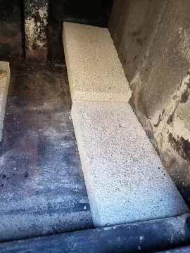

Are the firebricks generally this hard to install? I vacuumed out the stove and made sure there wasn't extra ash in the corners or edges to prevent a tighter fit. I'm wondering if the 8" would be better. They are very tight and I won't be able to install them unless I make some cuts or try and sand down the edges. I'll need to make cuts for the ash pan and the back of the stove.

Normally no, Measure them up. Maybe they are slightly oversized? If so a coarse sander or a grinder can remove a 1/4" quickly. Mark in advance.
2 stock bricks have the corners cut off on a 45 degree angle, the back & side bricks cover the cuts.
These are the 2 rear corner floor bricks
View attachment 286371 View attachment 286372
Did you go on the pe website and check out the brick sizes for your stove.i noticed you bought bricks from sbi ,those stoves have differant sizes throughout. My osburn has 3 different sizes of bricks.just saying.
Most PE stove take the standard 4.5 x 9" firebrick. This is pretty much an industry standard. The SBI bricks are ok if they are pumice brick. As hogwildz noted, the rear bricks need the corner shaved off in order to fit. There is a short brick next to the ash dump too.
