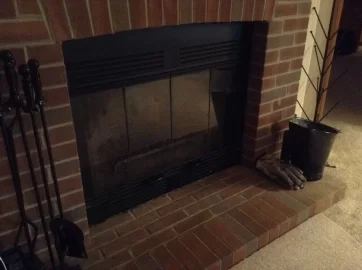

Thanks for all the feedback. My hearth is 18.5" and the height is 23.5". Attached is a picture. I only desire to heat the living room and not the entire house. My living room is rather large and open. Would it make any difference with a pellet stove insert vs wood stove?
That's a low height. Just to make sure: Has it been measured from the hearth? If you only want a supplemental heater the Quadrafire Yosemite should work as rear-vented stove. Another would be the Regency H2000 hearth heater but that would require a hearth extension.
