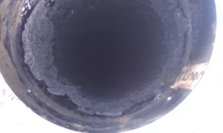

Burn 24/7, swept the chimney myself after ~12-13 weeks of burning, have gone through about 3 chords, maybe 3.5 by now of wood.
I got a 32oz coffee can worth of light brown flaky stuff.
General consensus, when I posted pictures of the pipe and amount, was that it was an excessive amount
I think the important thing is you got up there and did it mid season, so I think it really helps the safety factor no matter what.
