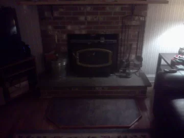

I've been thinking about a new stove/insert for a while now. I am heating my 2700 sq ft house with an older Avalon 1196 insert which has a 2.5cu ft firebox. Most of the time I keep my house comfortably warm but I would like to do it all the time including the cold snaps when its in the single digits. My fireplace has a small opening which limits my choices of inserts. I might be able to squeeze an Avalon Olympic in it with luck. Bigger inserts like the Summit wont fit. This has brought me to thinking, I know dangerous, right. Can I do some demolition on my fireplace and add a freestanding stove in front of it.
If I remove the hearth and tile or brick the floor I should be able to put a big stove in about the same footprint as what I currently use. I think the new tile/brick floor would end close to where the hearth pad in the front of the picture, maybe a few more inches but close. The current hearth is 18" and the pad is 24".
I am considering a BK king as an option but I want to know what I can expect for burn times in a big home. Tell me what you would do if this was your house.
