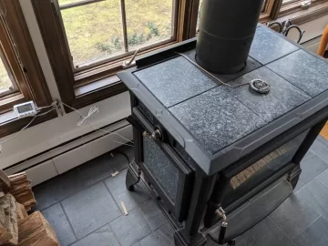

Here's my heritage going from cold start to above 500 dF stove top this morning. Started around 9:45 (late start today) with 4 small splits, some kindling, and a couple sheets of loose newspaper on top to get the draft started. Over the next hour I found that one of those splits was not as dry as the others and flue temps plateaued around 500 (not high enough for proper secondaries), but by then there was room to fill up more, so added four more splits, filling the firebox. The dip in stove top temperatures in the graph around 12:15 was where I moved the thermocouple probe further away from the flue collar to where it is in the photo.

Those flue temps are high. I suspect this may be Fred Bear's issue too. Highbeam reported this problem with his Heritage as well. It's odd because some people have normal flue temps with the Heritage. Just a guess but it seems like strong draft sends combustion up the flue instead of staying in the firebox.

Thanks, I'll see about measuring the draft or adding a damper. In my case this is double walled pipe with the primary air setting at the stove all the way closed. What should I be looking for for internal flue temperatures? I've been reading lots of old threads, but most ended up discussing the variations between the bimetallic types. In more normal cases (stove less full) I see peak flue temps closer to 800 dF.

The graph shows peaks in excess of 900ºF. This might just be that the air needs to be closed down much sooner or that the splits are too small or that the wood is super dry. Or a combination of these factors. Ideally you would be turning down the air with a probe flue temp of around 5-600ºF. This will vary with the stove, draft and fuel. On our stove I start turning down the air to about 50% at 400F probe temp and all the way down about 5-10 minutes after that. I try to avoid >800F flue temps.

The only one of those that I can rule out is wood being too dry -- quite the opposite. Much is dry enough but a lot is still marginal. I'll need to wait another year until I can larger splits from stuff just stacked this year. I'm not re-splitting anything anymore unless I want a moisture reading. Getting the air completely turned down between 500 and 600 is indeed what seems to work without collapsing to a smoulder. I'll try some other variations such as the first step earlier. Perhaps I'll be able to turn down the air sooner when I have less marginal (20-25%) stuff in the mix.
