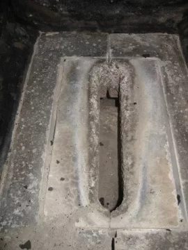

After only 1 heating season the refractory in the loading chamber of my Tarm Solo40 is corroding out, crumbling.
Has anyone had any success with the bio-heat warranty on this issue?

I just spoke with tech. support @ bioheat. My worn refractory which I pictured in the above post will be coverd by warranty.
This is a very powerful forum. It carries much weight with the dealers. When a company does right and stands behind their product it should be noted. Bioheat (formally Tarm) has come through for me twice now.
Hey everyone big bump here I havn't been on in awhile but havn't had any issues either till now :(. The refractory chuck has pictured has broke on my Tarm was wondering how hard was that to replace?? And anyone have any clue how much it costs?
Chuck - I'm in the 5th year of burning with my Tarm Solo 40 Plus, and the refractory looks pretty close to your picture. That refractory is 2-3" thick, and I would expect some gradual wear, but unless something radical happens with mine, I expect maybe at least a couple of years to go.
I'm pretty gentle with the refractory, not throwing wood in in, not over-cleaning it, and then with a soft touch. I don't think it is important to keep it very clean of ashes, and I usually leave a couple of inches of ash on the upper refractory. I do gently clean the tunnel and don't let much ash build up in the tunnel. I hope you a few years left of use on your refractory.
I bought and replaced the bottom stone and the Refractory Insert stone last spring. Tarm covered 50% of the cost of the bottom stone under warranty. the bottom stone was $105 before the discount and the insert stone was $175. You will also need sealing gaskets for the stones. They cost me $27 from tarm-Bio-heat. Total time to install both stones was about one hour. I used a vacuum cleaner to clean out the channel around the insert stone first and then lifted it out.Before I removed it I installed wood shims to support the remainder of the floor. you can slide the bottom stone out. I used 3M spray on adhesive to glue the gaskets on while you drop the stones in place. I was a little nervous at first but this project went real well
I had the same issue with my tunnel. I took pics and Bioheat said it was ok, just place back in place and run it until and if it totally crumbles. That was last year, now on my 5th year. I have the solo 40 and my insert stone is $125. I'm going to go ahead and get one to have in stock so if it does go I'm not down for long.
