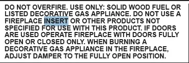

Where did you find that an insert was an option? I couldnt find anything in the manual stating that. Did they issue an adendim to the manual?

If they are not concerned about blocking the vents dont let thdm do the job. Even if the fireplace allows an insert to be installed in it you cannot block those vents.

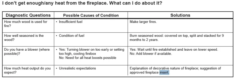

It shows up in a couple places. One on the UL label and then in the tips at the end of the manual.

Ok i missed the statement in the troubleshooting section that implies there are approved inserts. I did see the other statement which i took to mean do not use a fireplace insert. If they have a list of approved inserts then great that would clearly be an option.

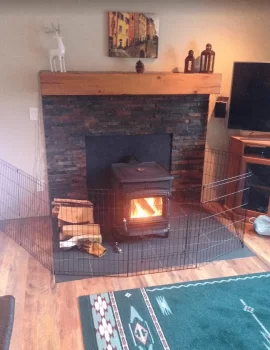

I had a zero clearance fireplace that looks similar to yours and installed a Jotul F45 in front of it (hearth mount). The installer ran a liner through the zero clearance chimney and replaced the top so that it was correct for a 6" flexible liner. I already had built the hearth so the install only took a few hours. The inspector came out and approved it.
Its been working great all season (I burn everyday) and was a lot easier than tearing it all apart.

Are the cooling vents around tbe fireplace unobstructed? What about the coolong vents at the top for the air cooled chimney.
I didn't see the installation in person but to my knowledge the cooling vents are not obstructed. The steel plate behind the wood stove (covering the old zero clearance fireplace) is not sealed.
