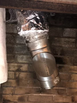

Hi all,
I have the liner down the chimney, but the liner has to angle to get from the flue to the fireplace. It's proving difficult (or I'm proving too weak) to bend the liner so that it descends the last little bit vertically. Is there any problem with leaving the tee (two-piece tee) at an angle as long as the snout comes out and connects snugly to the wood stove? Thanks so much!

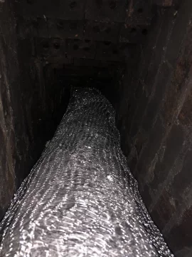

Thanks begreen! It’s an Mflex flexible liner and I’ll attach pics of the angle. Would a flexible liner be at risk of buckling?
[Hearth.com] Tee at an angle okay? [Hearth.com] Tee at an angle okay?
Ah, the picture helps. I was thinking off-angle front to back causing tension on the liner. This looks better. If the snout can run straight & perpendicular to the stove back, at a slight upward pitch to the liner, then it should work ok.
