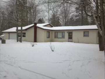

We bought a vacation home last weekend, and it has no stove. It's about 1350 sq ft, plus an enclosed and insulated breezeway. It has an LP furnace, so the stove wouldn't be carrying the whole load when heating the place up from really cold. It might get used a half dozen times in the winter.
I was going to wait and pick up a 30 in the spring, if they go for cheap, but this seems like a good buy. Will it be enough? What should I look for with a used PE?
This is a pic of the place. It has been added onto a couple of times, but it is pretty open. The stove will go where the brick chimney is, but with new class A thru the roof.

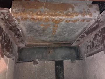

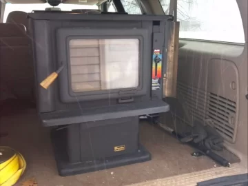

This thing is super clean. Baffle looks great, no broken bricks, no rust, glass is clear, no creosote buildup inside. There is ash still in the bottom, but no charcoal, so somebody must have known what they were doing.
It was a new homeowner, and the stove came with the house. He had never used a stove, and the insurance company wanted no part of it. It was in the basement, and there is no way any stove could heat that house from the basement. He thought the previous owner may have had a workshop or studio in the basement, and the stove only saw occasional use. He said that $350 must be a good price, because he has a lot of responses :rolleyes: I saw no reason to bargain, and gave him $350.
Three questions. How do I get the baffle out? Is the manual available from PE's website? And the door handle is sloppy. Easy fix?
Inside pic. Too dark in the back of my Excursion for the rest.

Sure is cramped in there.

That is a Very nice looking stove. The baffle should slide forward there will be a pin holding it in the back.
Remove the Pin, then slide the baffle forward, when it gets towards the front you need to just tilt it down and it should come right out. I have been selling and installing there products for the last 3 years and I have sold and Installed most major brands. It is hands down the best burning stoves and Inserts on the market. You got a steal on that thing you have to love Craigslist.

The manual is online on PE's website. The baffle comes out as described. But be prepared that it is going to be heavier than it looks. If you pull the baffle you should replace the gasket on the secondary feed tube that inserts into the back of the baffle. The door handle is a simple v notch slot. You can very gently tap on the top of the V to close the gap very slightly. A little tap is usually all it will need.
My only concern here is that short chimney, or is that for the propane furnace? Are you going to install a new chimney for the stove?

Yah, that part confuses me. I'm not sure what purpose the brick chimney serves or whether he will have the height needed yet. Even with a new chimney that looks like a low roof.
It confuses me, too. There is a too small tile hearth right there, and a brick facing on the wall. There is no hole thru the brick, but there is a ceiling support above. I think they covered the hole when they put the new metal roof on a few years ago. My other thought is to take all that stuff out, and put the stove on the opposite side of the room, in a corner near the other roof line. That would give me a good place to anchor a roof brace for more height.

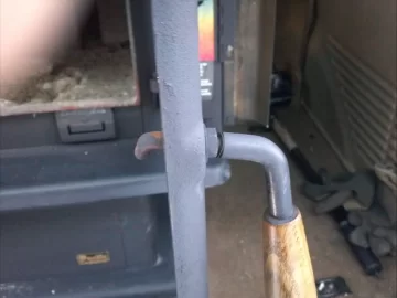

The door latch is fine, and seems pretty tight. It is the handle itself that is loose in the door. This stove was built in '95. Almost 18 years old, and in this condition ==c
Is the gasket on the secondary feed tube anything special? I assume that is the tube between the bricks in the back.

A little wobble there is ok. Our stove handle can wiggle if not engaged. I think Tom Oyen (thechimneysweep) is burning in a Spectrum of that vintage. He may have a suggestion for whether it needs tightening or not.

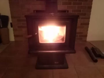

Well, we got here about 11 last night, and it was 58° inside. Not very chilly outside, maybe low 50s, but I finally got a chance to build a fire.
Filled it with ash splits, and a little kindling on top. About 10 minutes in and I was cutting the air back. About 12:30, I put a 4-5" round on top and watched it for a while. Nice floating flames, and the temp peaked about 600° with the air closed all the way. Got up at 8:30, and it was full of coals, and about 300°, just perfect. Right now, 18 hours later, the stove is warm to the touch, and there are more than enough coals to light another load. Unfortunately (?), it is 75° and sunny, so that is unlikely.
I'm not sure how it will do in the dead of winter, when this place is 20° inside when we arrive, but it will sure take a load off the furnace. Totally tickled with this 2cu ft PE.

The Spectrum is a very good shoulder season burner. My next door neighbor experiences the same thing with his stove. In winter you'll be pushing it a lot harder of course and burn times will go down. But it will stand and deliver the heat if asked. You will still need the furnace to help bring the mass of the the cabin up to temp from 20F, unless you don't mind being cold for several hours. It takes a lot of btus to warm up a stone cold interior.
