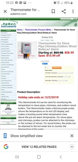

Does anyone have any experience with one of these stove pipe alarms?

Yeah I love mine. Mainly because I can monitor temps from upstairs
I have one. The alarm is loud and annoying (like what a good alarm should be). It has a high and low alarm, but you’ll never want to use the low alarm.
I also just got an Auber controller that controls my insert’s fan and works as a backup alarm.
The digital read outs and alarms make running the insert a whole lot easier. I’d recommend it.
I have one as well -- actually two. We have the one you pictured on our stove, and then the 210T on the Tundra (with the slave unit in the living space so we can see the display without going into the furnace room).
They work well, though one of them occasionally (couple times a year) gets a bad probe reading and sounds the alarm for less than a second, just a brief blip; I suppose there is some fault in it, but it works well otherwise so I don't worry about it.
We also run one of their controllers (SYL-2342) on the Tundra, and though I've only had it for a couple weeks, I like it a lot.
Auber's customer service is very good, though if you call them there seem to be no native English speakers there, and I have a hard time processing words on the phone. It is easy to get through to tech support (right away on the phone, and same day by email), and they actually know their products.
I got the 200t with the washer thermal coupler and the remote alarm / light. I just set the washer on the top of the stove under a small piece of scrap metal. I think I would have been better off with the probe and dill and insert it I’m my liner. Works great. Well worth the money.

Man im ordering one of these as we speak thanks for all the input
How do you monitor it from upstairs? Does it have an APP for your phone or did you run the display up there?

I ran the display upstairs. I have zero desire to have my wood stove linked to my phone

So does yours have the alarm are is it just for reading the temp im for sure wanting an alarm
Yes it has an alarm. I didn't add another though which was an option

Did you order the buzzer too are does the basic unit come with it in other words it has 2 different buzzers that each of t

Ok gotcha the option for the buzzer is to have a buzzer in a second room are something

I guess but the built in one is loud
I bought the red light alarm. Unless you are hard of hearing it’s pointless. As Bholler said, the built in alarm is very loud. You can hear it throughout the house.
