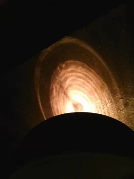

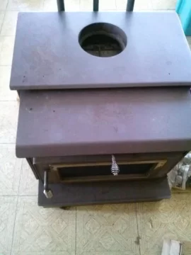

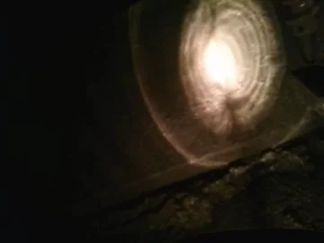

Okey dokey - I did my best to show pictures of what I see inside the opening. The flue is not straight up and down. It slants off to the right of the fireplace (as you are facing it).

yeah flue looks oval for sure if I is good luck getting an adapter to fit and you need a good solid airtight connection between the insert and that liner. I am sure it can be done but it wont be easy
It looks like you are complicated by the fact that the liner is oval, and does not hang down to reach the stove the way liners are suppose to.
To me these "ovals" look like the light pattern from the beam of a flashlight.
I can't see much of anything, let alone a liner, in these photos.
