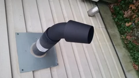

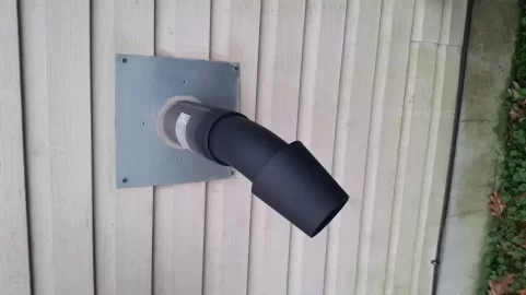

[Hearth.com] termination cap question [Hearth.com] termination cap question [Hearth.com] termination cap question
I dont know why they are sideways but here ya go for your viewing pleasure.
N-I-C-E!
