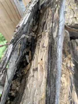

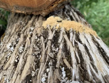

I bought about 20 or 30 Osage orange posts from a guy, for fencing. It looks like some might have termites, when we stacked it at home! lots of saw dust shacking out. I know nothing about termites as a risk. Could I pass these suckers to my regular wood stacks 20 feet away, or my house 80 feet away? Here are 8 of the offending post.

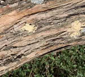

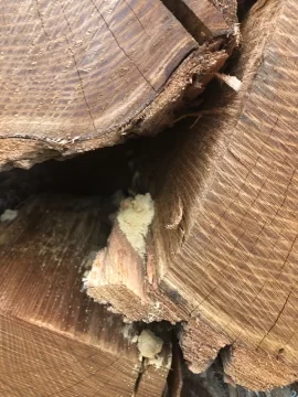

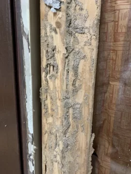

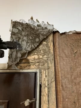

Like they said termites make mud not saw dust. Cut one up and see what the inside looks like. If there are termites in them they won’t last long as a post anyways?

I've seen a bunch of carpenter ants in osage and other logs, though relatively few termites. The carperter ants seem to make more sawdust / powder where the termites make mud as others have mentioned. Either way, the issue remains... insects in the wood. Seems like you'd definitely want to treat the wood and keep it away from any structures.
Just put the dusty posts far away from your house if you are worried. Let them dry and most bugs won't/can't bother them. If there are carpenter ants in the posts check them for integrity before setting them in the ground. If they have already begun to rot, then they might be a bust anyway.

Termites eat the wood, so there isn't any saw dust. The mud tubes are there to keep the humidity up.

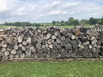

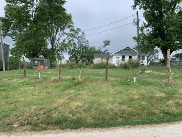

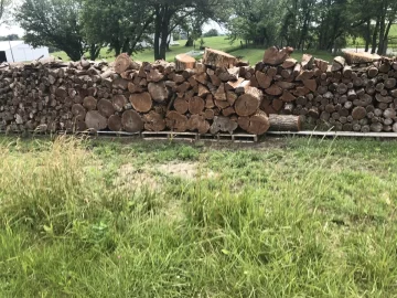

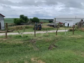

Thank you all for responding. We were going to use either straight treated poles or steel poles next to the building, and gates as needed, to prevent gaps so puppies don't get out. These post are lovely IMHO, and I love seeing them used.
QUESTION: If the posts get set in concrete does that mitigate the danger of soil transmission of termites, if they are there? or do they only move when the queen establishes a new colony. I had planned to set 2 pole, in concrete, near the house to fasten a shade sale to 2 post further away. Good to hear about cold weather not being hospitable to termites.

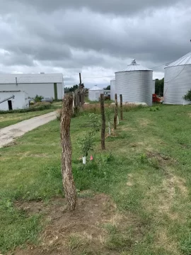

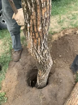

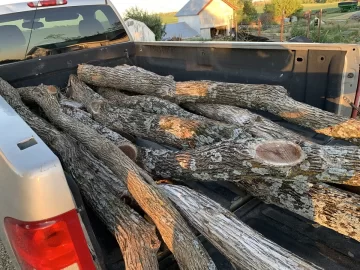

I have installed the beginnings of an espalier frame for 3 apple trees. I show this picture to show off these great looking post that will also go into my yard fence:

I highly doubt you have termites in those posts, most likely some type of ant. The ants will vacate the posts as they dry, those hedge post will cure with time, get super hard, be very stable & solid.
I would not set your posts in concrete, they will most likely heave over time. Gravel will be the best, if you just use the clay from digging the hole & tamp it good about every 8”-12” it they will be very solid.
Your Hedge posts will outlast those creosote post 2-3 times. A nice 10” - 12” Hedge post will make a great corner/hinge post. I always cut line posts at 8’ , braces at 9’ , corners @ 10’. Put your lines in @ 36” & corners in @ 4’-5’ depending on preference.

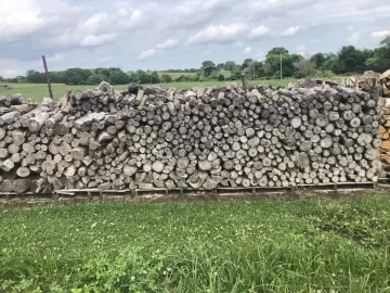

Here is some Osage I cut & stacked last fall/this spring there is a few piles of sawdust on it. I am no too worried about it in this stack or any of the other stacks, the ants will vacate.

Here is some 3-4 year cut/stacked Osage with no sawdust or ants
[Hearth.com] Termites in the Osage Orange logs I bought.
And some 35-50 year aged Osage with no sawdust or ants

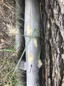

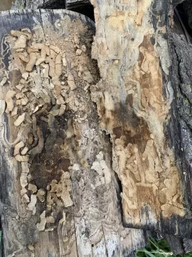

The osage was cut early this year. I am thinking something hatched out of it by the looks of it. its sawdust for sure on the osage. We have had osage post for 60 years in one of our pastures and they still stand. I designed this yard fence, to my husbands chagrin, though not embarrassment. He is going along with the plan. Ive been collecting the post from southern Iowa since early spring. I am just now noticing the sawdust exit holes on the post, that I did not see before. Both the new set, and the set from the spring are now sawdusty. They both came from the same farm/timber. The other logs I got elsewhere do not have this sawdust.
the last 2 photos show a nearby locust firewood pile, cut in early spring 2020, and cut and split that summer. Is this termite damage? if it is it has been out through the Iowa winter, so likely all dead, from my understanding.

JimBear, that second picture of yours, in your post before your post with the log stacks, is exactly what my pile looks like. Thanks for sharing those photos.

Your last pic is not ants but some kind of grub-precursor to some kind of beetle.. (someone knowledgeable will likely educate us as to which type). I see the same in dead standing pine.
Ants don't leave these "worms" of sawdust behind (though they do give those piles outside of the logs).
Reactions: EbS-P
The damage under the bark is likely a beetle and the stuff in the wood is probably carpenter ants.
Reactions: EbS-P and enduring
Osage will get borers while it's alive. And they do get some BIG cerambycids.
Pics in post #18 looks like borer sign to me, and restricted to more susceptable sapwood.

You have carpenter ants
One can be seen plainly in one of your photos
LOL, thats why I included that pic. There were other ants and insects on the wood scurrying around too. I thought carpenter ants were black though.
the bark picture is of the honey locust firewood.
