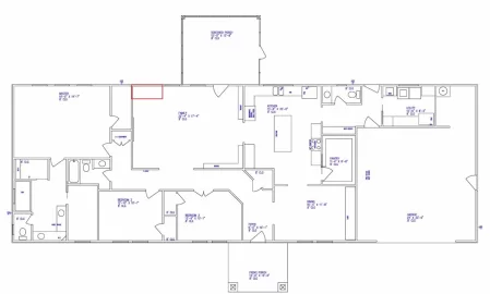

Here is a picture of the floor plan. The red box is where the brick wall and hearth are.
[Hearth.com] Texas Stove Choice

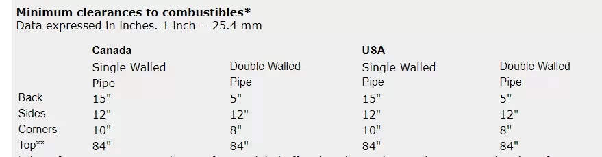

I honestly didn't think it would be an issue and only added the hearth after the fact. The whole house is stained concrete so we don't have any flammables on the floor nearby. According to the Osburn website, if you use double wall stove pipe, you can put the back of the stove 5" away from combustibles. Am I not reading that correctly?

No link showing, but I managed to find an older Osburn page listing the stove. It is indeed much shallower and has a low rear clearance of 5" with double-wall stove pipe. So 5"+18"+16"= 39". Sounds like you have found your stove if the hearth is extended a little.
Note that you can extend your hearth, for an ember protection only stove by just a strip of sheet metal nailed neatly to the floor in front of the hearth. The key is to select a stove that has this minimal requirement. That expands your choices if the desire is for a larger stove.
