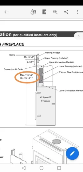

Woodhtr: quick follow up. Thank you for recommending the Apex stove. I hope that I'm getting the top clearance/ceiling requirements wrong as my dealer salesperson also recommended a ZC fireplace like the Apex, but the installer then said no-go because I'm right back to the top clearance/ceiling limitations of a freestanding stove. Attached are screenshots from the Apex manual that shows a minimum top ceiling clearance of 78.5". Did you already have this high of clearance? If not, how did you get around it? My installer is telling me that I have to, basically, raise the alcove height (which means cutting out part of the wall) to whatever the manufacturer says (and then back down to NFPA 211 tolerances). If, for example, I did raise the ceiling height to 78", I'd have a mantel that's nearly 7 feet tall!
Please tell me I'm wrong. I hope there's a solution. Otherwise, I'm likely gonna throw a fireback in my fireplace and move on. Much thanks.

Unfortunately anything you do will require more construction then you would like, also like I mentioned in my earlier post, your chimney pipe from the existing appliance to the cap will more then likely need to be changed to a class a pipe rated for either a woodstove or epa zero clearance unit (more work)
I dont know the floor plan of your house, but a simple free standing unit in a different area of the house might be a cheaper alternative, or you can do the demo work yourself. The brick stacks on either side of the stove are just stacks in front of a separate unit, the tile more or less is just mortared on either plywood or cement backer board with some front wood trim. more then likely you have double up 2x10's on either side of the unit making a simple wooden chase the fireplace sits into.

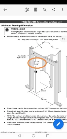

Sorry, here are the pics from the Apex manual.
Those are framing requirements there is probably a different section covering surface finishes

The 42 Apex specifies non combustible material above it up to about 80 in (or 78 in as you've stated) above the unit. This just means that you install a non combustible backing board like Durock board up to that height. Everything else around those dimensions can be drywall.
I ended up not installing a mantel because I hung the TV up over it, which is installed above the specified (non combustible)mantel height. This is probably not encouraged, but is not specifically disallowed.
Don't be so afraid of cutting out that part of your wall... its a less big deal than you'd think. Even if you went with a ZC fireplace, you will have to re-do the framing.
If you want a free standing wood stove in the alcove, it sounds like you will have to go with an alcove with ceiling height equal to the ceiling of the living room. This may not be bad aesthetically, but obviously you won't be able to do a mantel.

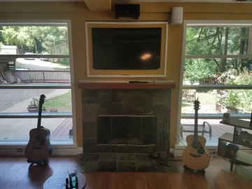

We replaced a ZC fireplace with a wood stove last year. We are now able to heat mostly by wood instead of using the propane furnace. We lose power frequently here in the California redwoods and this has greatly mitigated the impact during the winter months. We love the aesthetics of a wood stove as well.
This is what it looked like before:

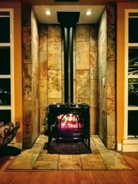

This is after. Note: we did lose the TV. There was no way to keep it with the alcove clearances. But, I like the new look:
[Hearth.com] Texas winter storm ZC conversion
The stove has a rear heat shield and blower. The walls are fire resistant with an air gap (you can just see it at the top and bottom of the sides. The stove pipe is double-walled. All of the work was done by the contractor recommended by the wood stove store and to code. I think our all-in costs, including the stove, was about $10K. So, not cheap. We'd do it again without hesitation.

Is there a 1" air gap at the bottom of those walls I can't see it in the picture. And it also looks like the side door handle is still there.
Yes, there is an air gap at the top and bottom of the walls and they are standing away from the backing by a 2" gap. The actual width of the alcove is almost exactly 14" on each side to combustibles without those fire-proof walls, but I was uncomfortable with the temperatures the walls were reaching on some early test fires, so we brought back the contractor to put the fire walls in. That reduced the width to 12" on each side today (I believe the manual says 6" is allowable).

Good to hear the gaps are there.
Great looking remodel! Nicely done.
