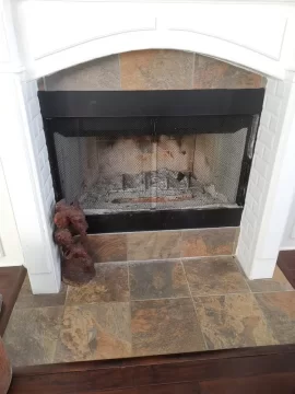

Hi all—
Brand new to the forum, and thank you in advance for any help you can spare. You may have heard how Texas had one of its worst winter storms in history a few weeks ago. A lot of folks went without heat for a week. Sinks that were left dripping froze inside the house. People walking for miles to get food and water. Wake up call for a lot of people. We were more prepared than most, but having to use my piece of junk zero clearance "it looks great on Christmas" fireplace to "heat" the house was my own wake up call. Nonetheless, the ZC is off to the graveyard and a freestanding stove is going in its place.
I've searched this forum, contacted distributors, and called manufacturers, and I can't seem to get clear answers (or can't get a call returned). I'm hoping the forum can shed some light on my questions. I've pieced together forum posts, but still need some help.
1. Once the ZC fireplace is removed, it will be lined with full brick (both sides, floor, and ceiling). Given that combustibles are behind the brick (wood studs and drywall for opposite room), would this still be considered a combustible alcove? Or is it a noncombustible alcove given the brick being installed? Makes a huge difference between clearance requirements and the stove size I can get. I've seen stoves just inches away from the sides of a true masonry fireplace, but I've also seen the same thing in ZC fireplace conversions and obviously don't want to run a fire risk.
2. I don't believe I can use the existing pipe. It needs to be replaced with insulated pipe, correct?
3. Confused on alcove ceiling clearances. In every manufacturer's installation manual, I see clearances for mantels and ceilings. However, mantel heights are often much lower than the ceiling height requirement. Am I understanding correctly that, essentially, the hearth/fireplace opening can stay matched to the existing mantel, but the interior ceiling height would be higher? For example, my hearth/alcove opening is 42" but the interior ceiling would be 62" (assuming 62" is the manufacturer's requirement). Picture attached.
I really appreciate your help. Unfortunately, not a lot of fireplace and stove resources down here in Texas.
Lastly, if my ZC conversion would be considered an alcove, then I'm really limited on stove choices given the 42" width. My wife prefers a traditional looking stove, and after searching and searching and searching, looks like the VC Aspen C3 is the only one that will work. Any other suggestions for a narrow stove that has a glass window?

Thank you everyone for your replies! I must not have notifications turned on as I didn't think anyone replied. I appreciate everyone taking the time to do so.
After speaking with a few (and the only) installers within all of Central Texas (not many to choose from in the hot south), a freestanding stove doesn't appear feasible without major remodel to the existing hearth: removing mantel, increasing height of alcove, rebuilding mantel, etc. I don't want to do a band-aid job and risk burning the house down, so to do it right I'm looking at 14-16k. Not nearly as simple as I thought it would be (tearing out ZC fireplace, a little masonry work, and stove install).
Thus, it appears I'm left with two options: (1) installing a wood burning insert or (2) replacing current fireplace with a newer ZC fireplace that actually works. There are newer models that have doors (which I'm looking for) and seem to be rated for actual heat (instead of just asthetics).
Here's my question: what's the better option? I have more options, I believe, if I replace the old unit. However, even between manufacturers, the term "insert" can mean different things (a true ZC compatible insert vs. masonry only insert vs. not being an insert at all but actually a replacement fireplace). I reiterate that one needs a Master's degree in this stuff!
Going the true insert route, I'm limited to very few options that are approved by the manufacturer for installation into the existing ZC fireplace. My ZC fireplace is made by Superior, model number wrt2042ws.
Insert vs. replacement? If insert is the route to go, any suggestions on models? I cannot thank you enough. If replacement is better, any ideas on models?
By the way, the existing hearth/mantel area is 42x42.

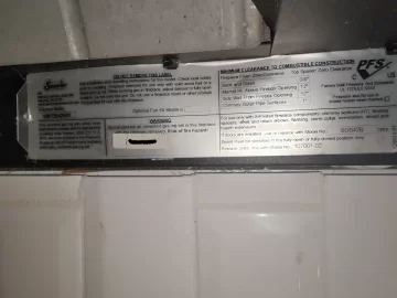

An insert is not an option read the label it clearly says no inserts
bholler: I am probably mistaken being a newbie to stoves, but the label reads "Do not use a fireplace insert or other product not specified for use with this fireplace". There are a handful of inserts I found where the manufacturers' manuals specifically approve their inserts for use in Superior ZC fireplaces, although I can only find one that meets my measurement requirements. Am I reading the label wrong? Thanks for your help.
Look up the manual. Unless that manual specifies inserts approved for use in that fireplace you can't do it.
Ok so I looked up the manual and it does say if the insert specifies this fireplace you can do it sorry
As of now, I can find exactly two, and only one where the manufacturer approved their insert for use in my specific fireplace.
Which 2? Lopi lists ok for installation in Superior for the Answer and Medium Flush inserts. Also, IronStrike has some inserts which may work like the Striker 160. Performer C210 and possibly their Montlake 230 insert. Ironstrike is under the same parent company as Superior.
That’s great that you’ve found at least one insert that is approved and fits. Can you provide details of the insert? If you provide measurements of your fireplace, the experts may be able to point you towards more options if that one doesn’t seem like the best choice.
I’m not as knowledgeable as the folks like begreen and bholler, but I did have to go through lots of research in getting our own insert done. I will tell you that I was told by at least one installer that I did not have to have an insulated liner. I knew enough to know that that was wrong, and we did not do business with that individual. Woodburning is pretty rare in our part of Texas (we’re south central, on the edge of Hill Country); wood burning inserts are rarer still, and it seems as though insulated liners are just about unheard of. I just want you to know going in that a fully insulated liner is probably a necessity for a safe install, but you might encounter some difficulty finding someone willing to do it.

Your safest bet is to stick with an insert that says it is ok for installation in a Superior fireplace. Then the next step is to see what actually fits. Then a dealer & installer have to be found.
