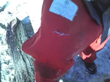

MMAUL just a nick but No Doctor bill here!

I did the same last summer. Now I wonder if I should buy a new pair - probably should.
I have a pair the same way. Mine the Kevlar never got touch so my GF glued in a patch. I know the safety police may not like that but the Kevlar is perfect.
Mine incident pulled out a ton of kevlar and jammed the saw blade, as it should.
HeatsTwice said:
Mine insident pulled out a ton of kevlar and jammed the saw blade, as it should.
So did MMAUL but didnt take much of the kevlar at all. Got to be 6 plys still there not sure what he will do? (Safety Police)lol Odd ball spot there in he was moving when the tree started to fall. Its a 361 so it likes to spin after you lift.

Thats why we buy them! He was moving off a felling tree it can happen to anyone. Mainly a 361. I know there atlest 3 years old (chaps) not bad for a young guy. Oh and he wanted to take pick's so other can learn.
Already patched. on further inspection took one layer of kevlar. sure beats stiches. took 5 minutes to cleanout the saw and was back to bucking.
MMaul, glad that everything worked like it was suppose to.
Zap
yeah I am glad they did too. If anyone is thinking they shouldn't buy a pair think again. this could have been a bad day.

Abasolutly when I met Jay he wore them and made several suggestions that I buy them, even thought I would never happen to me. But I rationalized it as $70 chaps are cheaper then an emergency room visit, it would be a good cautionary measure. I am sure glad I had them. Could have been 20 stiches instead of 5 minutes of cleaning a saw.
