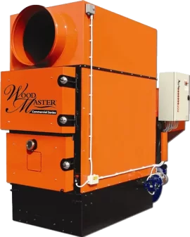

Well, maybe it's not, I'm not sure, but I'm going to set it up next Tuesday. It's 800,000 BTUS. The people that installed it originally used B-Vent to chimney it up out of the steel building. It had a chimney fire and all the aluminum smelted down back into the heat exchanger. Oooopsie!
I'll post some pics of this monster next week. It's made by Wood Master.

... etc ... The people that installed it originally used B-Vent to chimney it up out of the steel building. It had a chimney fire and all the aluminum smelted down back into the heat exchanger. Oooopsie! ... etc ...
Wonder if that could happen without a chimney fire?
I think it did. The fire was recently but it had been running bad for most of this season and I think that was the issue

I have a Woodmaster 5500 OWB and have liked it. Good equipment but it loves to eat wood. It will do multiple buildings and heat 10,000 SQ FT.
I'm curious as to how many pounds or bags of pellets this thing you are working on eats in a 24 hour period. I'll follow this thread for some reading,
51 lbs an hour max

51 lbs an hour max
WOW! That'd cost some cash. Even if it was using 40 lbs. an hour at say $4 bucks. 24 x 4 = $100 bucks a day. I assume they buy pellets in bulk. Big places cost big money to keep warm.
Are you going to Install 3" or 4" diameter pellet vent or Multi-fuel venting?

Hi Scott, could you use Class A on the furnace? Olympia makes 12" class A.
