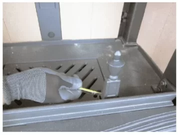

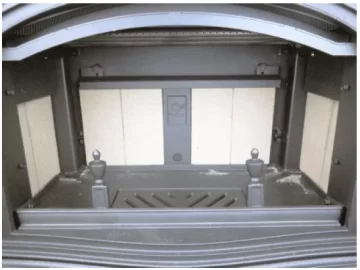

I haven't seen one in person yet, but it sure looks like a steel box interior.

When I talked with the rep at our local dealer on Monday he said it was, so when I saw Rays post I emailed Travis Industries (P.Ranes) this is what they sent back.
From Travis; To answer your question the Cape Cod does not have a steel firebox .
So I'll stop tonight at our local dealer to ask him.

I would consider a welded steel firebox a plus as this eliminates any leaks due to bad gaskets or crumbling stove cement.. Jotul has done this too with the F50 and F55.. And steel makes Bart happy too ;)

After Begreen posted the pic I sent off a new email to Travis, this is what came back.
Zap I’m sorry for not getting deeper into your question . We used to make a cast outer shell and a steel interior firebox . What D is a Stainless Steel bracket for our combustor , C is stainless steel 2nd burn tubes for EPA and A in the corners is for outside air for our 2nd dairy burn tubes.

That is a REALLY shallow firebox.
Yes it is definitely an EW loading stove hence the andirons.. I really don't like this feature.. The T6 and NC 30 have a nice square firebox so you can either way.. The T5 is 15-1/2" wide so works pretty good for this too..

I'm okay with east/west loading. A square firebox is great and is really flexible, but since five of the six stoves I've owned have been e/w loaders, it is what I am used to.
But, when it comes to a shallow firebox, I am referring to the depth of the firebox. Or, lack of, in this case. Not a lot of room for a good bed of ash and coals for this stove.

Ray, I think BAR is referring to the height measured from firebox floor to the bottom of the door opening. It looks like it's barely more than 1", not good for holding a bed of ash and coals.
The actual depth (front to rear) of that firebox does not look any worse than many other E/W stoves.
