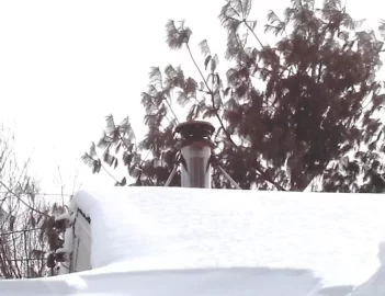

It would be cool to see some pics of chimneys during start up, burning along and then restarting the fire from coals so newbs like me self have a base line for what (or what not) one should see coming out of the chimney. I know it depends on the stove and wood and etc., but without opening a can of worms, I think it would help. It would help me at least.
So I like to answer my own questions.
First year burning and am satisfied with what comes out of the stack, nothing. Cruising around 450-500 here's what's coming out of my stack:

Looks like you have it figured out. Dry wood and good temps is is the best way to achieve this along with any type of secondary burn system.
Your pat on the back is in the mail. :-) Way to go dlpz. You are making a positive for all wood burners to show people how clean they can really burn and not pollute.
