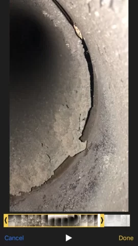

Previous homeowner burned a ton of wood. Since purchasing the home finally found time to look up the flue and see the pipe is seperated from the stove. See pic. The insert is surrounded by granite and wood trim. Is there any way to fix this from within the stove? It’s tight in there.

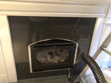

Post a pic of the face of the stove

Bholler will correct me if wrong. But that liner looks filthy with build-up! Sweep it and cleanup before doing any work would be my plan and make sure it’s safe to burn. Otherwise, you will be covered in soot and risking a fire when burning hot with good wood.
Yes it is very dirty and clearly needs cleaned. But i have no idea what type of setup this is so i cant give any advice at all. Which is why i asked to see the face of the unit.

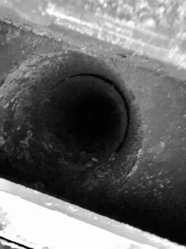

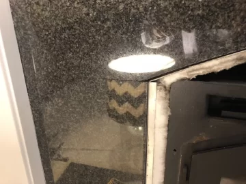

Additional photos. Happy to provide more as I don’t know what the professional eye looks at.
Totally agree it’s dirty and needs cleaned, no question.

I would clean it good so you can actually see what is going on. Has the whole system been inspected by a chimney pro?
It may be fine as it is. I really cant tell much from the interior pic because of the ammount of dirt. But if there is a problem no it cant be fixed from inside the unit. It may be possible to do it by going down through the top or the back wall may need opened up

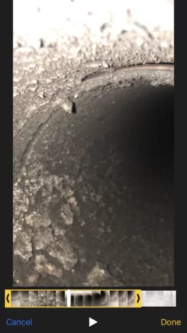

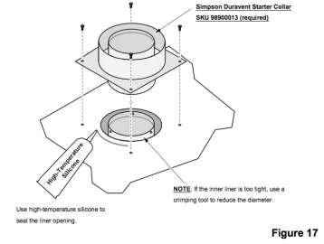

Agreed with the need for cleaning. The chimney starts right at the fireplace. I am wondering if what we are seeing it the end of the starter collar which should be attached and sealed to the fireplace top?
[Hearth.com] The gap
The end is corned in to aid in installation? Could the pipe be nice and snug just a few inches up? Im just spitballing.
Absolutely could be that is why an inspection by a qualified pro is needed. Or maybe we will be able to see more when clean
It's common to crimp the end of the start collar for easier fit. Hard to tell here until the chimney is cleaned.

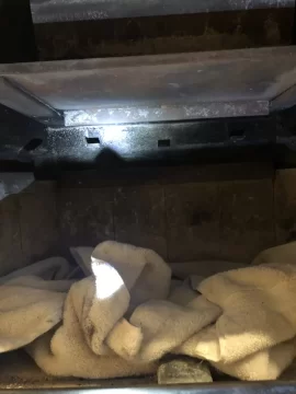

I found a screw on the opposite side of the gap. Something still holding on for dear life.
I bought the house in August and just got a chance to look at the stove. Will have professional out bf striking a match.

People get all worried about gaps. Notice how there is no soot or creosote in there? Why?
To ease some minds on this, go look at the draft hood on a gas water heater. It is good to be concerned about safety, but most fears on this situation are unfounded. The laws of physics are on your side.
