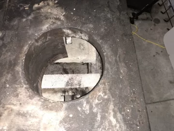

Hello world of wood stove enthusiasts,
I recently bought a Glo King GK 400 HT-I (the insert model) on Craigslist. I’ve been struggling with a couple ‘new stove’ questions that I can’t seem to find straight enough answers too. Especially as my stove seems to be from a closed down company.
First: what kind of firebricks to replace some of the cracked/ crumbling ones with. They’re odd sizes: 12” x 4.5” and much lighter (pumice?) than the traditional ones you buy at Tractor Supply. Should I just cut the normal heavy ones down to size and stack them where needed?
Another question that I’ve been toying with: some of the insulation behind the bricks is a little worse for wear. Should I look into replacing this? In my evening search I found some ceramic insulation that seems to fit the bill though I have no idea how I would attach it if I did tare out the old stuff. Regardless it seems I should replace the ceramic blanket that rests above the firebricks above the wood box.
Any pointers would be greatly appreciated! Thanks!
