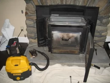

The weather ins't going to get any better so I figured I should get started. I trimmed the Harman extension and then had a friend tack weld the cap on. Drilled a couple of holes and put some screws in it too. Now I will caulk it and it will be ready for the roof tomorrow :rolleyes: Yeah!

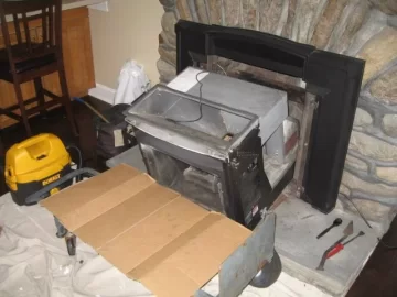

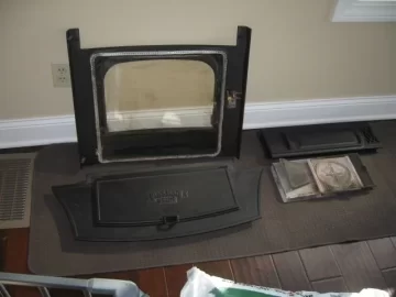

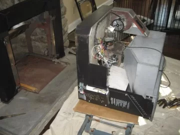

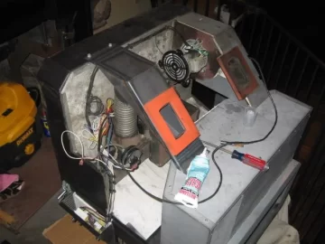

Now onto the inside. I cleaned the stove. Scooped out the pellets. Then I took as much off it as possible (i.e. door,hopper lid ,etc) makes it much lighter. Then I put it on handtruck.

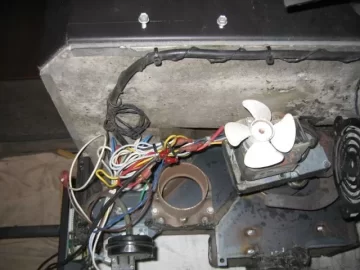

Thanks to everyone this forum I felt complelled to remove and clean the distribution blower, exhaust fan and a few others things:mad: Sometimes I really hate you guys!!_g:).

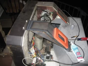

Next I'm going to see if I can get the OAK installed on the insert frame and the back of the stove. Then onto making a block off plate....woo hoo great fun. I know I won't get to it all tonight because I have to attend a board meeting tonight. I also can't leave the work area as is....or I might as well sleep at the meeting hall !!:eek: Lol.

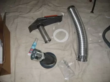

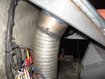

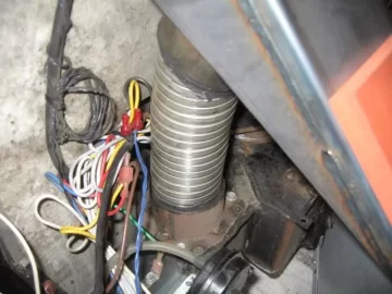

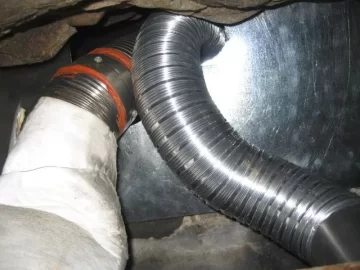

Brian that piece,the small hose and the lower left piece came with the harman inside OAKit I ordered. The larger hose and the aluminum adapter I picked up at store.
I installed the piece on the back of the stove...the rest will have to wait for tomorrow :)

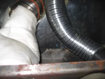

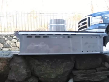

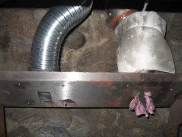

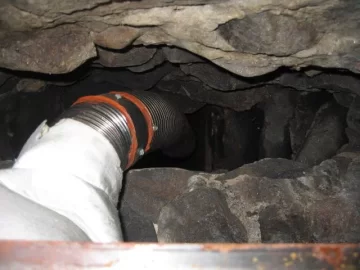

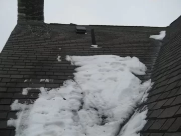

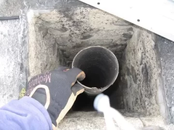

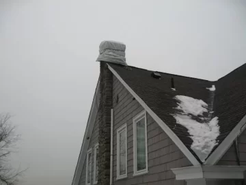

Ok looks like things are getting back on track. Yesterday the weather forecast was wrong but I moved forward anyway. I cut away the old caulk (all 2 tubes of it :eek:) and removed the old cap. Then I did the "leaf blower trick" and gave a quick brushing. Marked and drilled the holes to mount the new cap. Then I went to install it and realized I ddin't have enouch "slack " in the liner. :oops: What's that saying measure once...do it twice?!?! Anyway. So I was less than happy and running out of time. We had tickets to Disney on ice ...of course. :) So I screw the cap down (no sealant) and got off the roof. Then I get call from the wife...uumm have you looked at the radar? Doh!_g I scramble around looking for someething to cover chimney....I got it the pellet pallet bag.:) Back on the roof and wrap up the chimney then I came back down not in a very good mood!
Got in the car and took my twin 6yr old girls to the show and had a GREAT time :cool:.....chimney what chimney!
So picked up a couple things this am and hope to get back on the roof this afternoon ....Stand by!

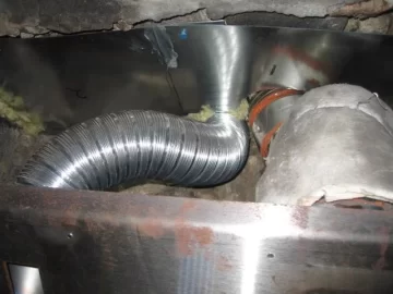

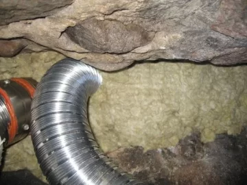

Chimney cap in on...finished it while the rain started! :rolleyes: Installed the intake hose and cut in the block off plate. Tomorrow I will stuff chimney with Roxul and figure out how to fasten/seal the block off plate.

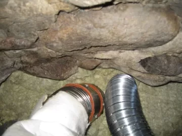

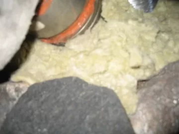

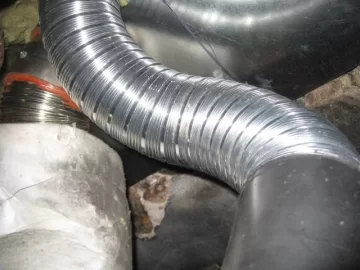

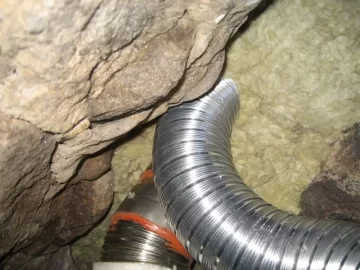

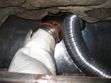

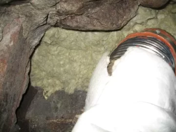

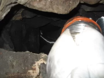

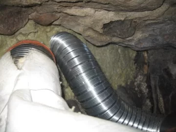

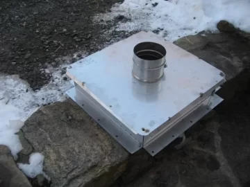

Hey guys I'm trying to figure out the best way to seal /fasten my block off plate.
My chimney is very irregular (old fieldstone ). I trimmed it as close as possible but there are still some decent gaps.
Ideas?
Drill a couple of holes and tapcon the plate in then stuff roxul in the gaps
A friend told me to use a little spray foam. Even though it won't be exposed to much heat I really don't like that idea.
Birdie, it is Lake Quassapaug
If you look up at reply#9 image 6404 you can see the largest gaps. Between the " pipes" and back wall of fireplace. 2-3 inches

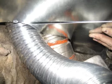

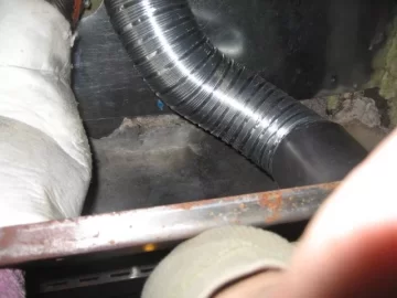

We think alike! I use to camera to make sure I got the tight areas. It is easier to stick a small camera up there than trying to get my fat head in there to see ==c Even though I try to get it in there...as you can tell by the self pic. Maybe I can start sellin my pellet ash for a spa treatment! It sure made me beautiful!! ;lol
Does this pass inspection??!! (Sorry for all the pics but I love it when someone documents a project. So I'm trying to do my part)

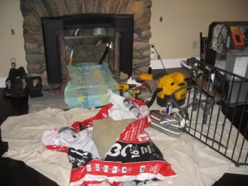

Block off plate is done!! ::-) Glad I'm only doing that once!
Now its time to clean up and put the stove back in the fireplace ...woohoo!:)
Hey Who took out all these tools!!!:eek:

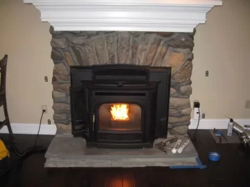

WE HAVE AN OPERATING OAK!! :) Now we need cold weather so I can test it out
  • [Hearth.com] The OAK install begins
Err, the test is how well is the stove burning.
No real need to wait for the cold. Usually if an OAK isn't doing its primary job the flame will be lazy and the wrong color and size.
I take it you want to see if the drafts are as bad as they were.
Agreed Smokey. Flame seems to be great. The stove just kicked down and the flame is small but dancing away. So I'm pretty happy. When it's cold you can't miss the drafts in my house. I am working on sealing them up but the weather allowed me to install the OAK So now I'm curious how much it will help for now! :)
