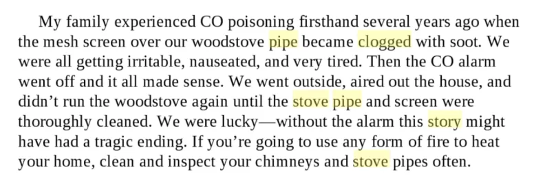

This can happen with a wood fire too if the screen is plugged and the draft is lazy and reverses at the coaling stage. It's why having a proper functioning CO alarm is important.
This is from a story by the editor of Outdoor Life.
This is from a story I read a while ago.
Yes absolutly it can but typically with wood people notice because of the smoke. Anthracite has no visible smoke and many people dont notice the smell.

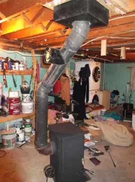

My chimney was triple insulated stainless Simpson Duravent. It started from the floor joists in the basement as you see here:

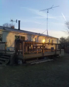

And then went straight up through the house and exited here:
[Hearth.com] The old "I wouldn't burn that in my house" thread...
From what I can tell, aside from that slight 45 degree angle coming off the coal stove I cant see how I would ever lose draft. I had the pipe that high off the house because wind coming over the roof would hit the chimney and momentarily reverse the flow. Once I added another section and made it this high, that never happened.
I'm not being sarcastic, I would really like to know.
Atmospheric conditions, negative pressures in the house, low fire in the stove and warm temps outside, wind conditions, we have seen trees fall on caps screens get iced up screens get clogged with fly ash and i am sure there are other things i am not thinking of. That is why co detectors are so important for anyone with any combustion source in their house. Yes if it is set up right it should not happen but even then unecpected things can happen.
Yea I guess a tree would have been possible if one were close enough.
That chimney setup worked better than any I've ever seen. Its followed closely by the current one I have in my cape style house. That one is 20' tall. I never get smoke in my house from my wood stove insert unless you whip the door open quickly and even then its just a small puff.
I get completely baffled when I see chimney setups with long horizontals and such. And I do see that in friends houses. I try to be nice about it though, I've told them a few times what not to do yet I continue to see it anyways. Then I hear later down the road their house fills up with smoke...
I did have a co2 detector so that was covered.

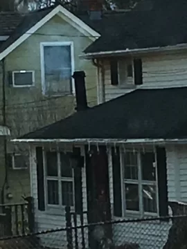

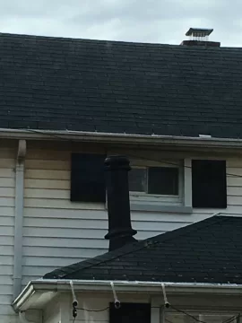

Saw this today on Main Street. Wondering how long it will take to either...
1-be cause for a 3-Alram fire
2-get shut down by Inspector or
3-meet the owner on this forum
Love how the siding is turning brown...

Wonder what is inside connected to that shorty?

In all reality the house will probably not burn down. The smoke is probably not anywhere near hot enough to ignite anything by the time it reaches the siding. Im not saying theres no way it can happen, Im saying its probably not likely.
Also, I don't think town inspectors have the right to barge in your house and shut down your wood stove. The only real authority I know of that towns and/or police have regarding wood stoves is if your stove belches out so much smoke that the neighboring house can reasonably consider that a nuisance. And that kind of stuff certainly varies by region.
The whole purpose and point to the inspector is to ensure proper install so that some day the next home owner can rest assure that things are to code.
Even if they could, you have the right to make them leave your property. Shortly after I moved into my house about a year ago, and after my stove was installed (without a town permit...GASP) as well as other interior improvements we had done, the town assessor ironically and casually dropped by during the day in hopes of being able to do an interior assessment of my house. My wife and I were at work, so a note was left on the door letting me know to call their office to set up a time to have this done. That request was thrown in the garbage and I've heard nothing since.
