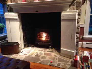

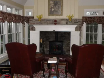

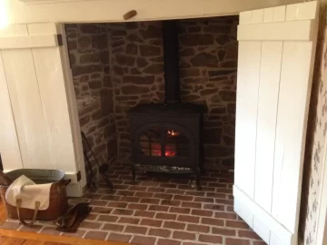

Oh, and just in case there's still one person on this forum who hasn't seen the hearths into which they'll be installed:
[Hearth.com] The "pick Joful's new stove" thread! [Hearth.com] The "pick Joful's new stove" thread! [Hearth.com] The "pick Joful's new stove" thread!

I have no idea, but, wouldn't it be better for you to heat with those stove out a few feet more? They look really tucked in to me, I know that your heating a lot of space over there...
