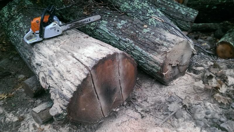

So I gave it my all again today. Ended up using the 251 again.

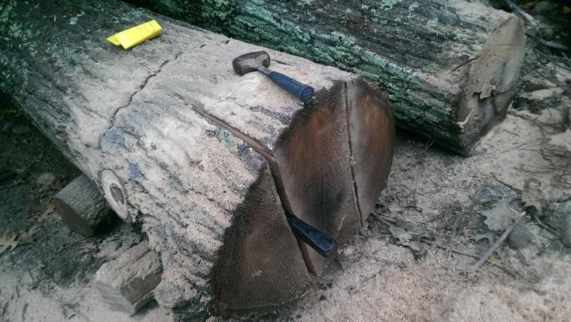

I need 24 inch lengths so I noodled 18 deep before cutting them off to make them lighter for splitting. It would be a lot faster and easier if I had the 25" bar on the 362.
