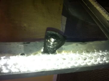

Double check the door gasket with a folded over dollar bill. fold length wise. Go all the way around the door.

There is the problem. Use WD40 or similar and spray the door latch. Wait wait wait for it. Then remove the nut and alter the location of the washers so it tightens the seal. I do not want to say, I told you so. Just kidding, you have my phone number.

What do you mean alter the location?
Move the washer (s) to the other side of the lug. Page 56 of your manual diagram #4.

The dollar comes out with a slight tug, but the same thing happens. Could it be the gasket (the rope looking thing) that goes around the door?
Yes. Tightening the latch will compress the gasket more. The loose gasket is causing the stove to lose vacuum and shut down the auger (any air leak will lower vacuum levels inside the firebox).
