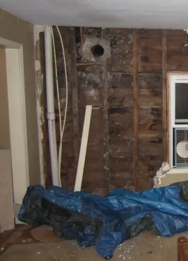

I've enjoyed reading through several of your threads. I'm new to this site, and am in dire need of some advice. I bought an old farmhouse and would like to get a wood stove (looking for a good used one) up and running.
I will need to go through a combustible (2x4) wall into an exterior block chimney (16x16), which has a 6x6 clay liner. The chimney stands right against the house and has been used in the past. It has a cleanout at the base outside. Someone built and used a "thimble" of sorts with some not-so-fancy masonry work that I'm not comfortable using. My plan is to drop down a couple of feet (the current one is quite close to the ceiling) and make a new hole through the combustible wall and into the chimney and liner (and frame around the hole as needed for clearances). I would then seal off the upper thimble void and install a stainless steel liner. Enter the thimble -- I have no idea what to use! I've seen "insulated" thimbles from $30 to $400. Any advice or resources on what I might need for this install would be greatly appreciated!

Another consideration: Do I need to move the water and sewer lines that run in a wall cavity adjacent to the thimble? This is turning into one monster project .........
